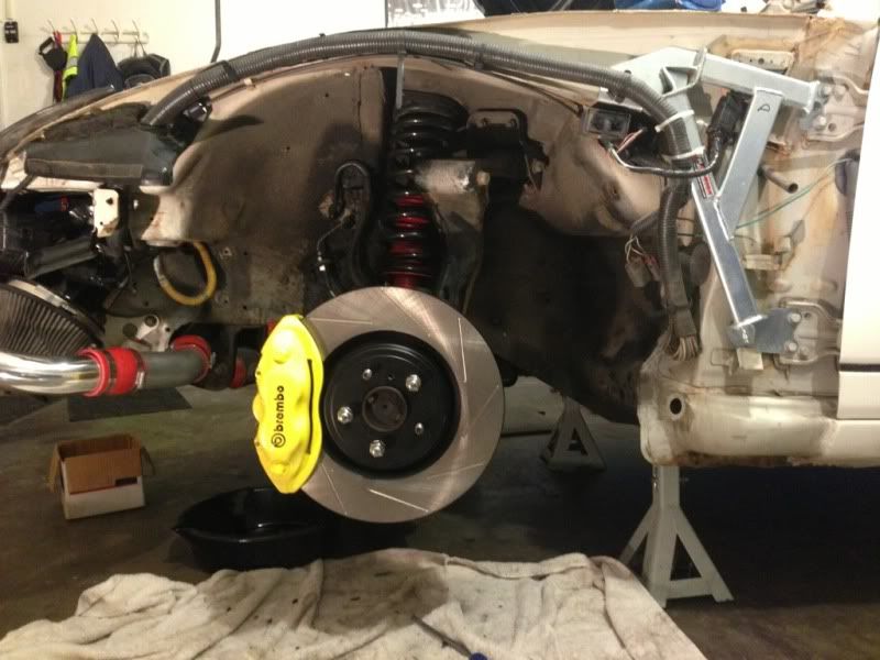

Old set up stock calipers with 350Z track rotors, brackets, and SS lines
350Z track rotors 12.8" vs Akebono Nismo 370Z 14" rotors
Stock Twin Turbo calipers vs SRT-8 Brembo calipers
Here's an example of why you need the shorter bolt, it will hit the caliper.
I could not the bolt at all the local hardware stores and didn't want to risk settling for something that kind of fits, so I trimmed nine threads

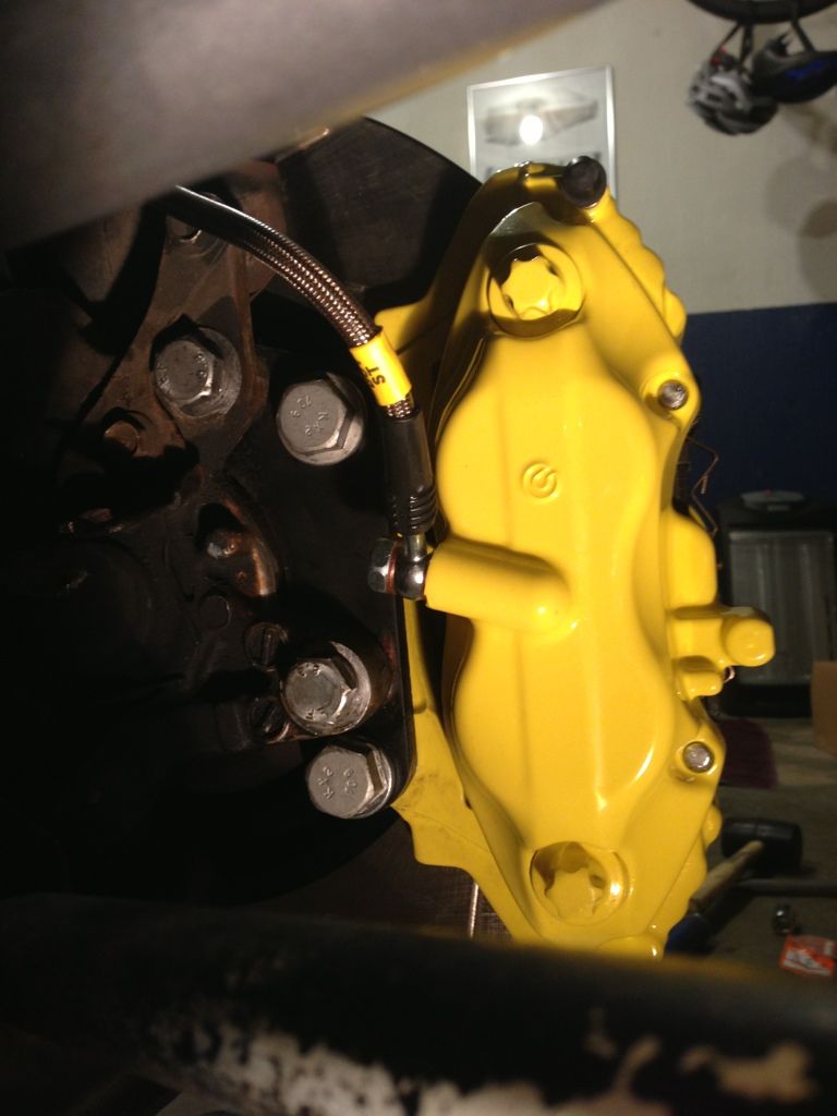

I could not reuse the other bolt that go from the bracket to the caliper because they were too long since I had brackets for the 350Z track rotors. Again, I could not find bolts to match the bolts pattern needed for the Brembo calipers, and again didn't want to settle for a critical component. I went to a Dodge dealership and picked up the bolts that match the Brembos. Had to trim approximately 8 threads and for the bottom bolt, trimmed the head. My StopTech SS lines did not come with the banjo bolt, so I also got that at the Dodge dealership. The bleeder screws were purchased at Advance Auto Zone. I did not trim the dust shield at all.
StopTech Stainless Steel Lines
Final result
